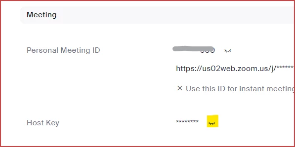

    Now the meeting owner needs to look at their Profile page on the Zoom Web Portal (https://zoom.us/profile)
    See the Host Key which is represented with a bunch of asterisks for security purposes.  Click the little eyelash symbol, and your Host Key will be visible.  (Note: You can change the Host Key by clicking the Edit link at the far right.)
    The meeting owner gives this to a trusted person who will be attending the meeting.  Since the Waiting Room is disabled and the Join Before Host is enabled, anyone can join the meeting during the time allowed.  The person with the Host Key brings up the Panelist window, which now has a "Claim Host" button.  Click the Claim Host button, type in the Host Key and click Okay -- now that person is the meeting Host, and has all of the privileges that a Host would normally have -- including re-enabling the Waiting Room, if that's what you normally do.
