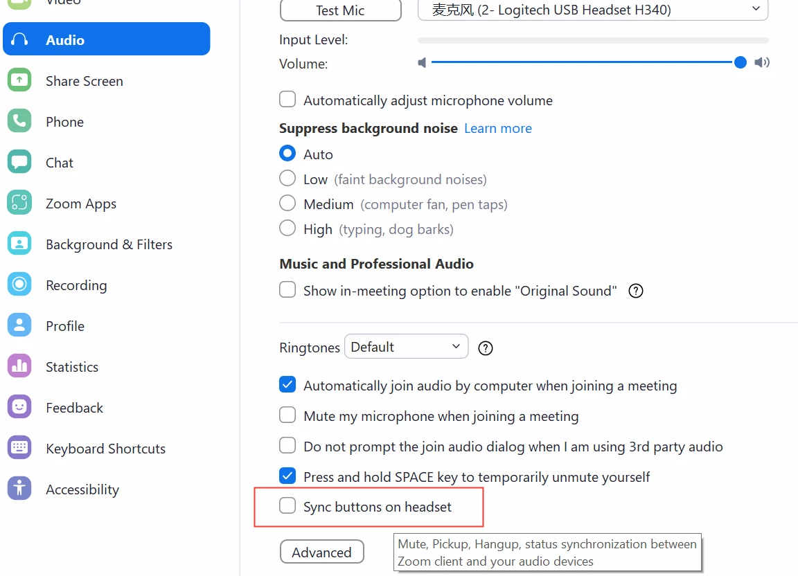

try to uncheck this setting and test it again
