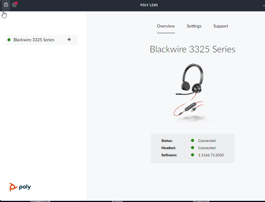

try updating the blackware 3310 with poly lens.
plug your 3310 into a usb port on your windows pc.
download and install poly lens on your windows pc.
Poly Lens
connect the 3310 to your windows pc and update its firmware.
then try your 3310 on zoom meetings.

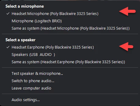

you should be able to select your 3310 as the speaker and the microphone.

I have already tried your solution, but it did not fix the issue. I updated the software on my Blackwire 3310 to version 1.116673.2050, but the problem persists. I have also selected both the speaker and microphone options for the 3310 when using Zoom, but it is still not working.

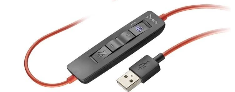

hp poly says the blackwire 3300 series is certified for both ms teams and zoom.  hp poly has both ms teams versions and standard versions.  the ms teams version has the teams logo and the standard version (not ms teams) has a handset icon.
Poly Blackwire 3300 Series - Corded UC headset | HP® Official Site
is it possible that you have the ms teams version?

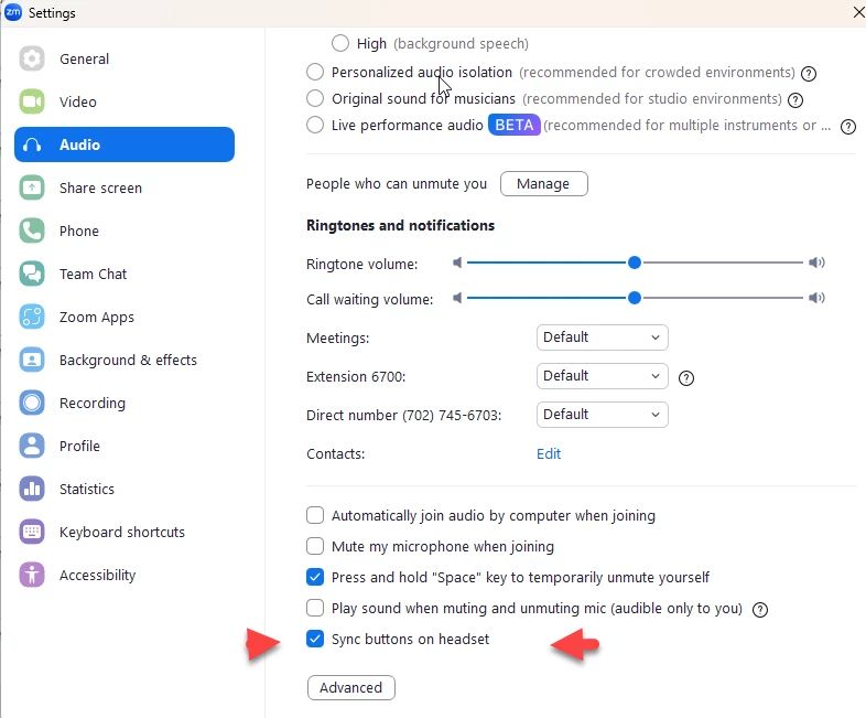

check to see that synch buttons on headset is checked under your client audio settings.
thanks,  eliot
