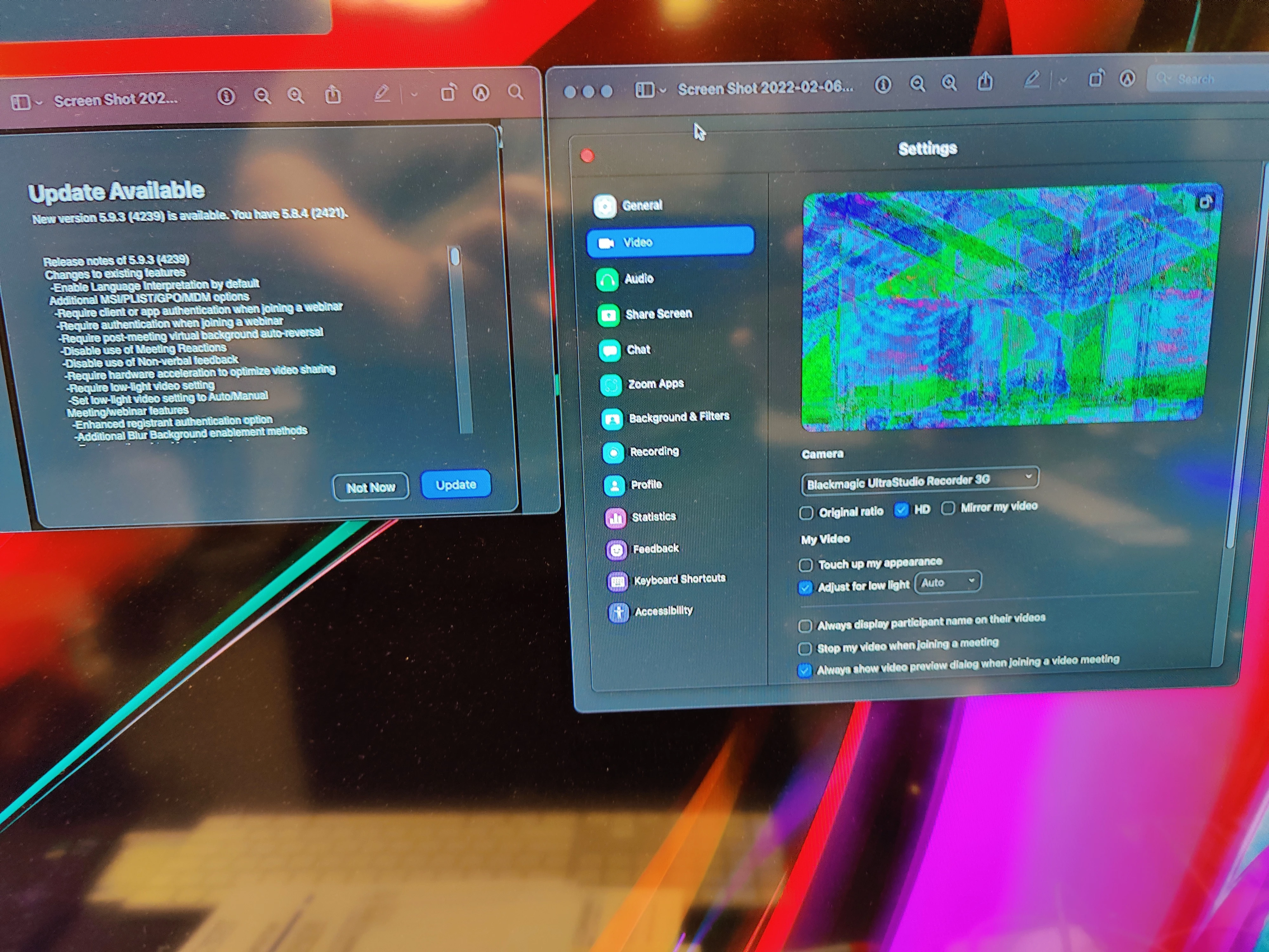

    I am using a Blackmagic Recorder 3G for video input. It works great under 5.8.6, but gives me green static under 5.9.1 and 5.9.3. I am running Catalina 10.15.7 on a 2019 16” MacBook Pro. My Blackmagic drivers are up to date (12.2.2). Hopefully this can be solved on Zoom's end.

    I'm getting the same messy greenish screen. My workaround is to use ManyCam for my BMD camera because it works fine that way. Good thing, because ManyCam didn't use to support BMD, but now it does.  I worked with a zoom tech for awhile to try to fix the problem, but alas it is still not fixed. I've also pointed them to this message board in case others would like to help their techs troubleshoot the problem.

    Still reporting the same issue.  Something I have found is that some signals work.  For instance my Sony camera and my MacBook Pro output produce this green garbled image, but the output from my Raspberry Pi works just fine.
    Additionally OBS, BM Media Express, etc show the picture fine where Zoom does not.  At this point I've downloaded an older copy of Zoom where it works to get by for now.

    The latest release of Zoom, version: 5.9.6 (4993), on MacOS 12.2.1 on an Intel MBP is successfully working with my UltraStudio Recorder 3G driver version 12.2.2 using HDMI. 🎉
