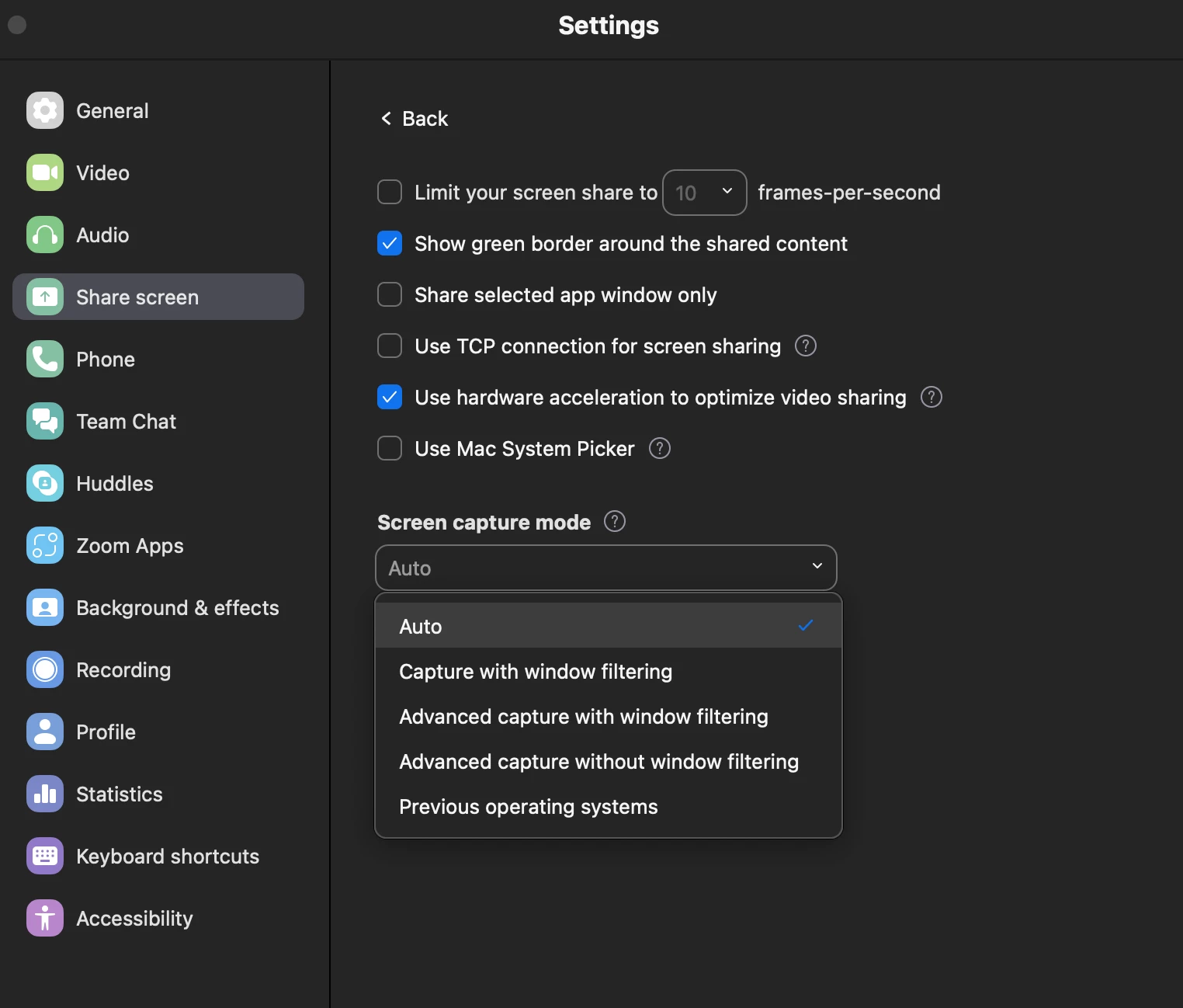

Thank you for the response. On your desktop app, try going to Settings > Share Screen > Advance, and then on Screen capture mode, you can try the options that would best fit your device when screen sharing

I fixed the issue for myself - there's a setting inside Advanced Screen Sharing for screen capture mode. I tried all of them, and "Secure Share with Window Filtering" fixed my issue. I don't have permission to upload the screenshot, but the path is: Settings -> Share Screen -> Advanced -> Screen capture mode -> Secure Share with Window Filtering
