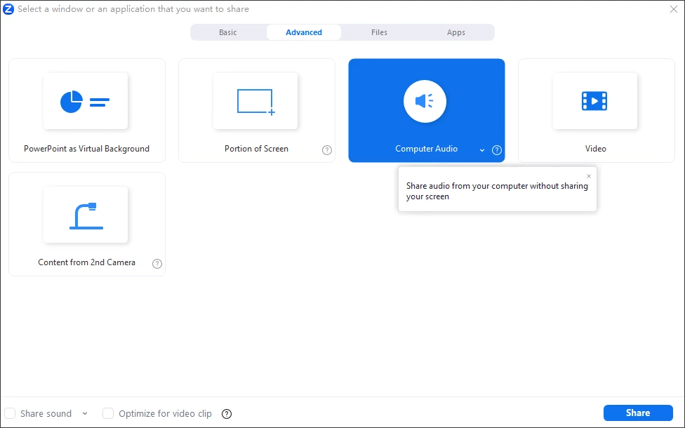

Another way is to press "Share Screen" and under the “Advanced” section, press "Computer Audio" (as shown below). This will allow you to share the audio playing on your computer without having to share the screen.
This method may be better because the music is played independently of the speaker's audio, and the two are dual-tracked without interfering with each other.

Thank you. I have tried that second option but it keeps distorting the voice, now that the music is clear. I too lead meditations and it would be great to have a clear sound on music as well as the voice of the speaker.
