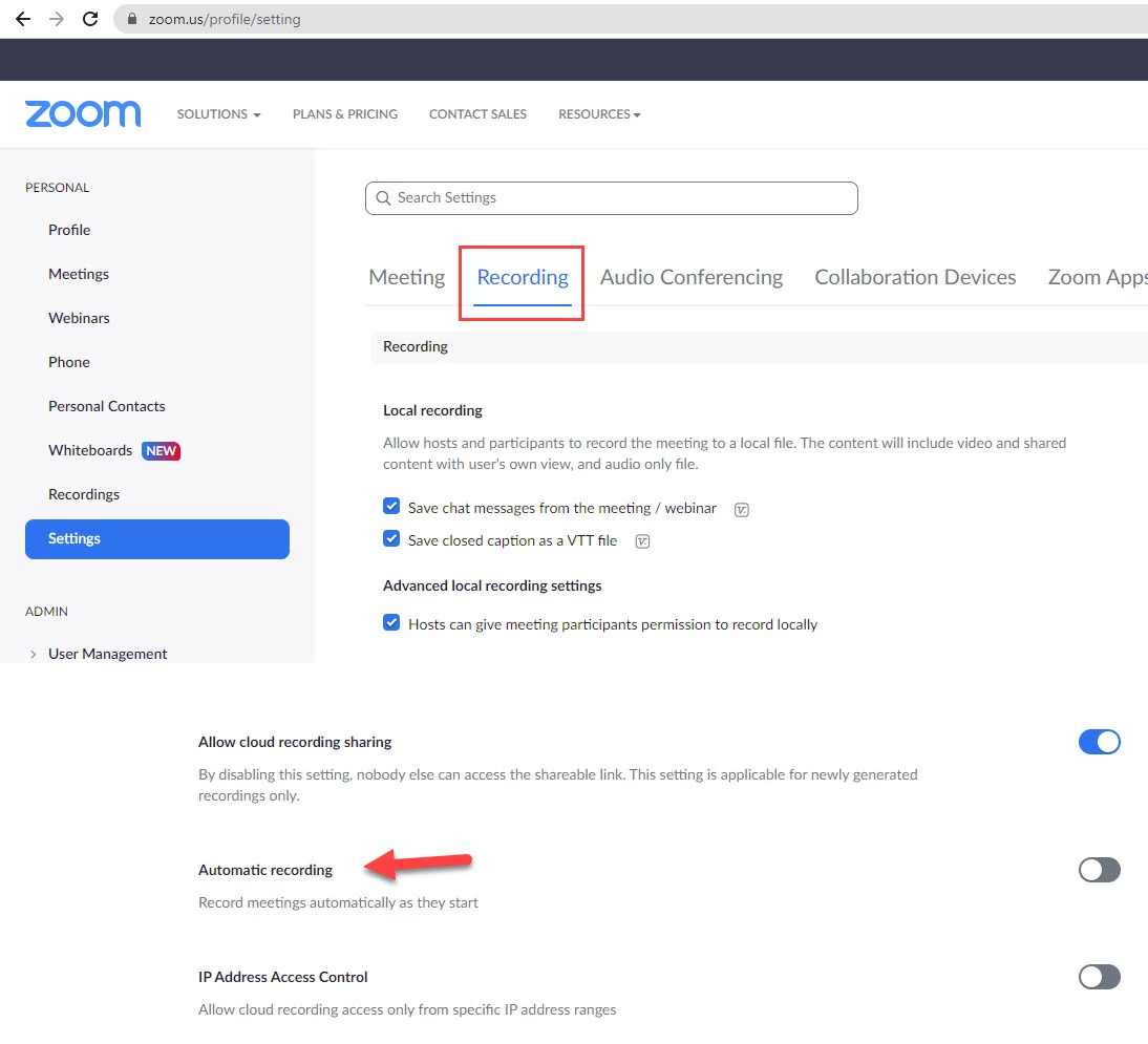

    The automatic recording feature is turned on. You need to turn it off.
    1. Sign in to Zoom.us
    2. Click Settings
    3. Click Recordings
    4. Scroll down and look for Automatic recordings. Turn it off.
    See the screenshot. I hope this helps.
