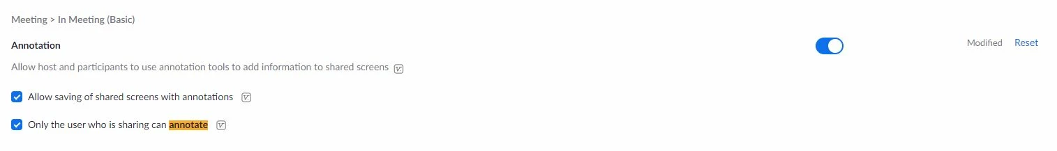

    Double check your user settings, make sure Annotation is turned on??  And/or one of the sub-options says "Only the user sharing can annotate."  Maybe that needs to be changed to off??

    I think the problem is that the user on the other end has annotate turned off. I created a short video on how to turn it on and sent it to the client.In hindsight, I should have had her fix it while we were Zoom-ing and then tested but I did not do that. I do not remember having the problem again, however. Not very scientific but there you are.  If I run into it again, I will see if this solution works in real time. https://youtu.be/BxRasJGFn_k

    Hi. Came here looking for a solution and found this post.  Same issue here.  Annotation on a client shared document etc. usually works but not always.  Very frustrating as then you have to ask for their document, or other item which aren't always possible, and do it from your screen.  I also watched the video @JanfromEarth  generously made and, rats!, everything was as it should be.
    February 1, 2024
    thanks for the video, though my settings are as per the video, still can't annotate on chromebooks or tablet type devices.
