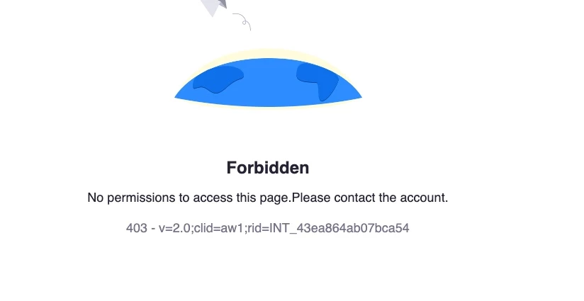

I'm trying to register Zoom webinars through a Pardot form on a Pardot landing page, following the instructions here: https://support.zoom.us/hc/en-us/articles/206003126-Using-Zoom-Webinars-for-Pardot
When I fill out the form, I'm redirected to a page that says "Forbidden No permissions to access this page" (see attached).
I put in the code to redirect to a different landing page, but that's not working either.

    Hi @robwalte Use the following instructions to enable Zoom's Pardot integration to use Salesforce OAuth instead of Pardot-only login.
    1A. If not yet installed, go to the Zoom Marketplace and install the Pardot integration. After authorizing, you will be directed to the Pardot integration configuration page.
    1B. If the integration is already installed, go to the Pardot integration configuration page on Zoom Marketplace:
     Pardot integration -> Manage -> Configure
    2. On the Pardot configuration page, click the "Use Salesforce SSO" link at the bottom of the page:
    3. If not previously completed, install the "Zoom for Pardot" package in your Salesforce environment. Do this by clicking the "Install Package" button on the Salesforce SSO setup page.  Ensure that you are logged into your Salesforce environment as an account admin when installing the package.
    4. Verify that Connected App OAuth Usage on Salesforce is unblocked:
    5. Verify that the OAuth Policies on Salesforce includes Permitted Users
    6. Go back to the Pardot integration Salesforce SSO Setup page and click the "Authorize" button:
    7. After authorizing, enter your Pardot Business Unit ID and click the ‘Save’ button. The setup is complete when you see the "Pardot setting is saved'' message at the top of the page.
    Let me know if that helps you resolve your error!
