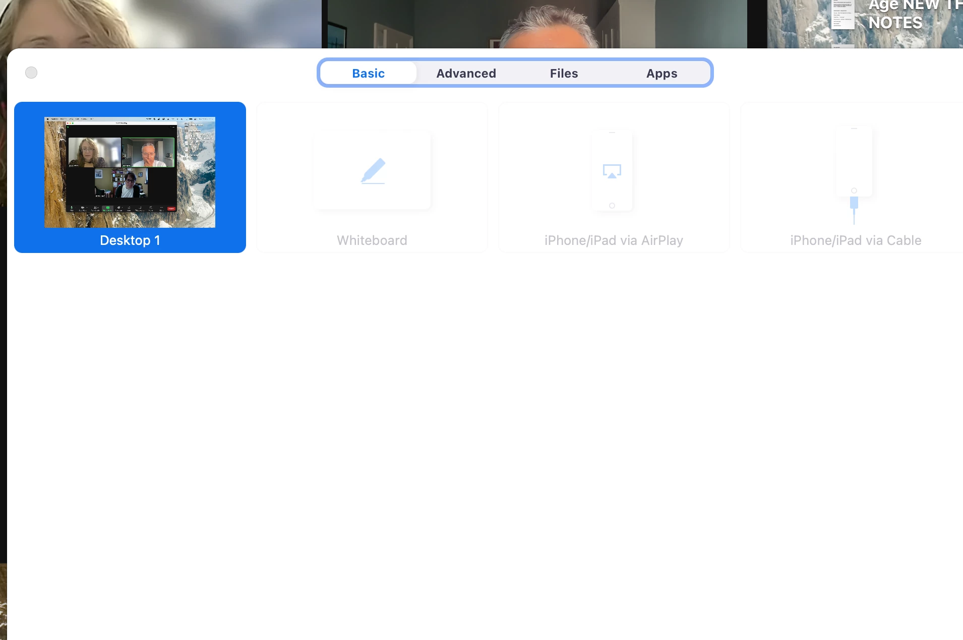

    I've worked out exactly when the problem occurs.
    When I simply share the full laptop screen in Basic mode, the images come through the audience in crisp resolution.

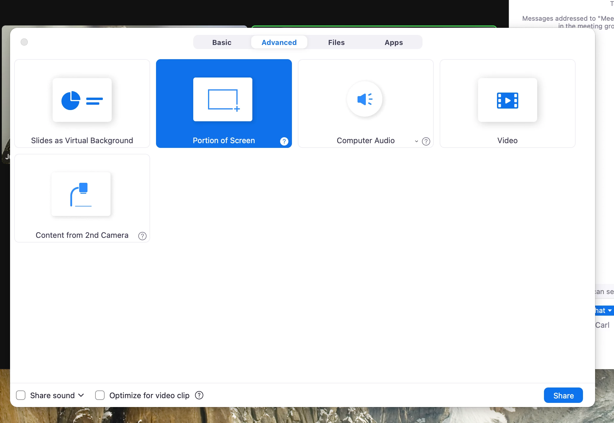

    The resolution only drops off when I move to the Advanced mode and choose Portion of Screen. That allows the viewers to see only the Portion I select (ie. current slide) – but those images are all lower resolution and a bit blurry.
    Which is weird. Because you'd think that sharing a smaller part of the screen would make the resolution even better!
    Still, the problem clear lies in moving from sharing my entire screen to sharing just a portion.....
