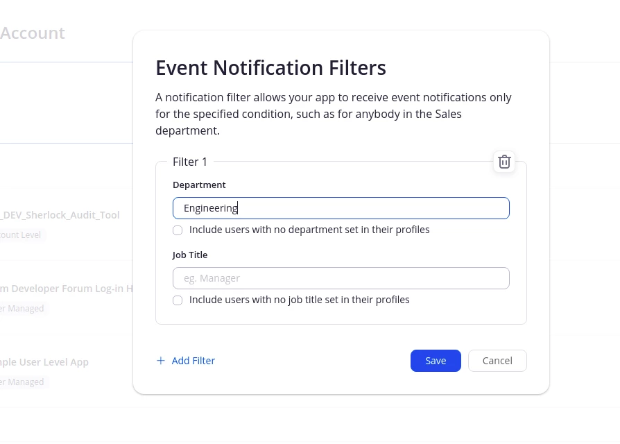

    Hi That worked well as suggested by you. Wanted to know some more ways of filtering.
    Here I came across this event notification filtering option in `Apps On Account` tab.
    I tried adding Engineering as the department filter value. I was expecting to receive events from sub accounts(who installed this app), who does not have Engineering as their Department name. But i was able to get events.
    So not sure, if my understanding is wrong with using this filter? Am I missing something ?

    Arps
    Jan 11, 2022 6:04 PM UTC
    Hello!
    So if you put Engineering in the filter, you're still getting the events for accounts that have installed the application but the do not have Engineering?
    Ashwin95Author
    Jan 12, 2022 3:54 AM UTC
    Yes I'm getting events even for accounts that do not have Engineering.
