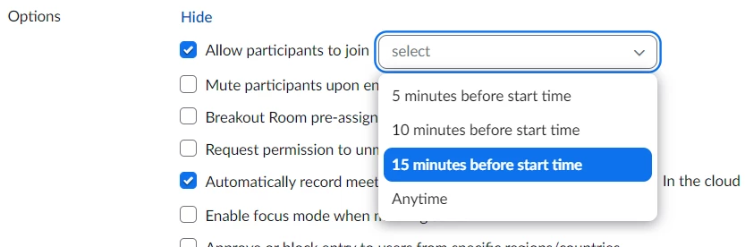

    There is an option on the Join Before Host setting to limit the amount of time in advance that someone other than the host can "start" the meeting:
    I recommend using the 15 minute selection. but if this continues to be an issue, set it to 5 minutes.  Often times attendees get there a few minutes early and stay... but the ones who get there and either realize they had the wrong time or that they're wayyyy early for the meeting, those leave and end up creating the phantom short recording.
