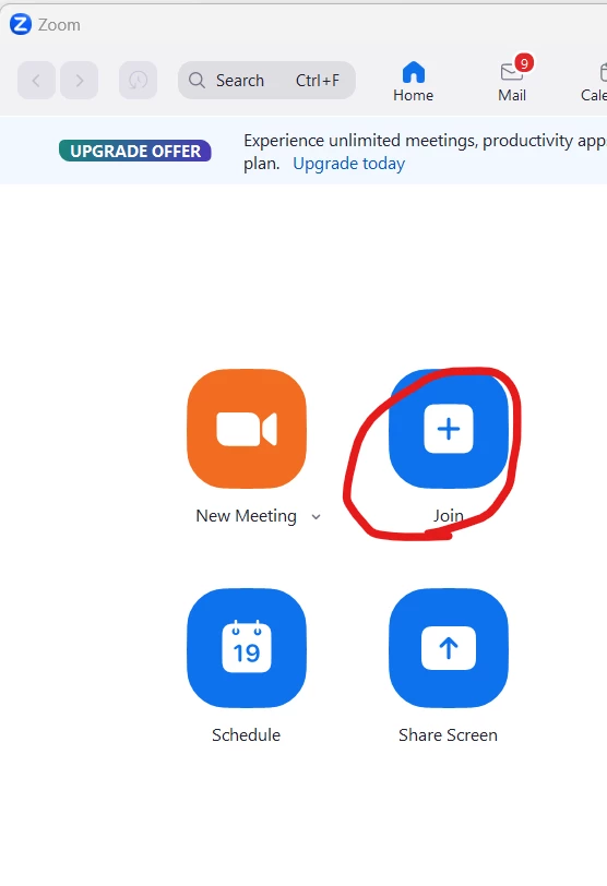

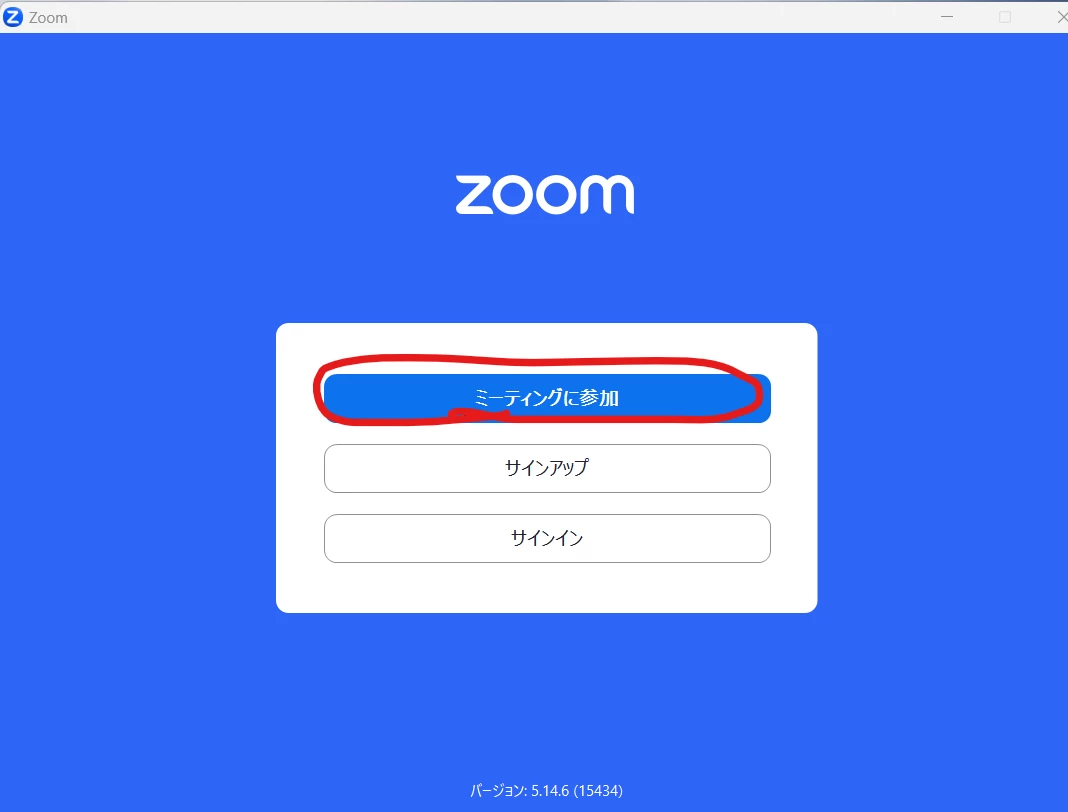

Are you participating via the Zoom app?
Enter your meeting ID through the zoom app instead of the invite link to join before the host starts!

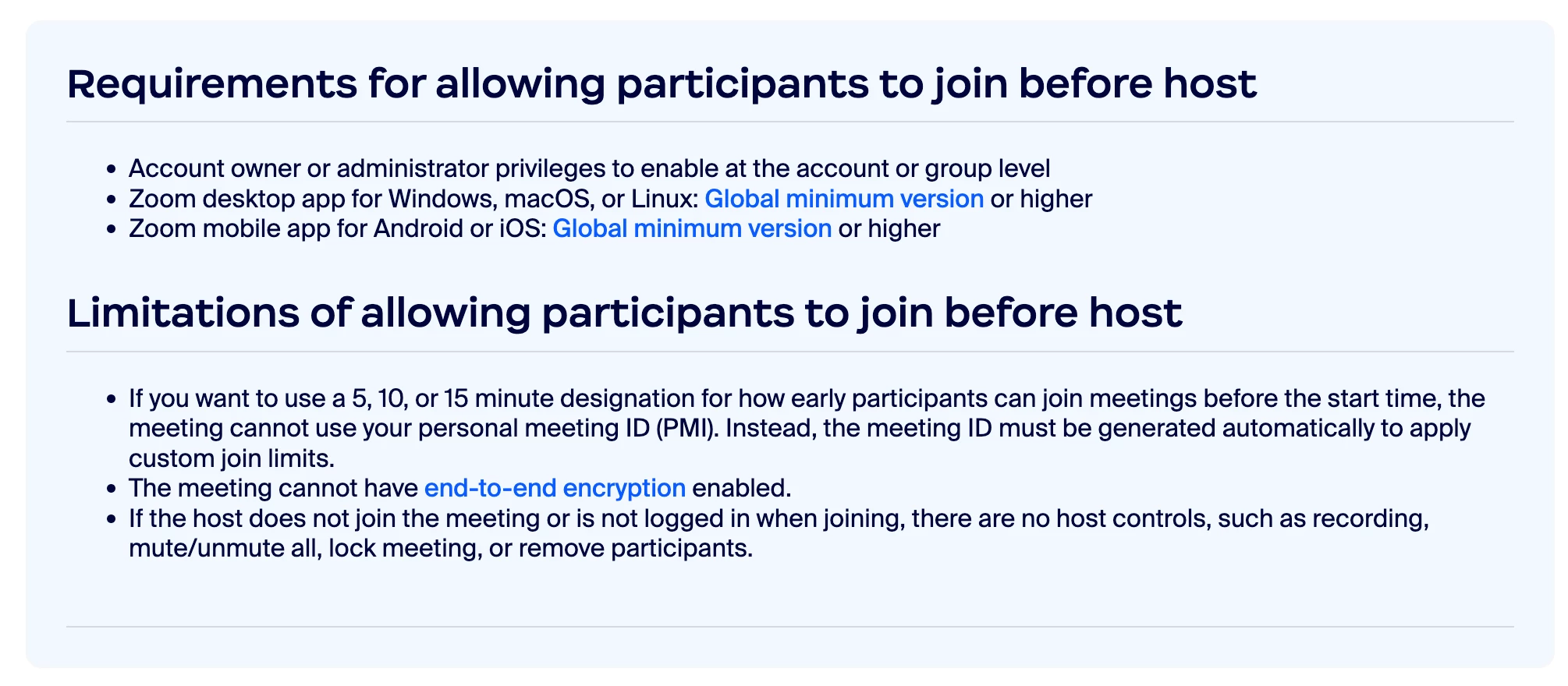

MGSR
Dec 2, 2024 7:20 PM UTC
Hello @NishaL,
Please verify if end-to-end encryption is enabled. If it is, kindly disable it.
You may read more in this article.
