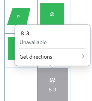

I have set up Zoom Workplace Reservation, but when I try to reserve a room or table, it says it is unavailable even though there is no reservation made by anyone else.
Does anyone know how to solve this?

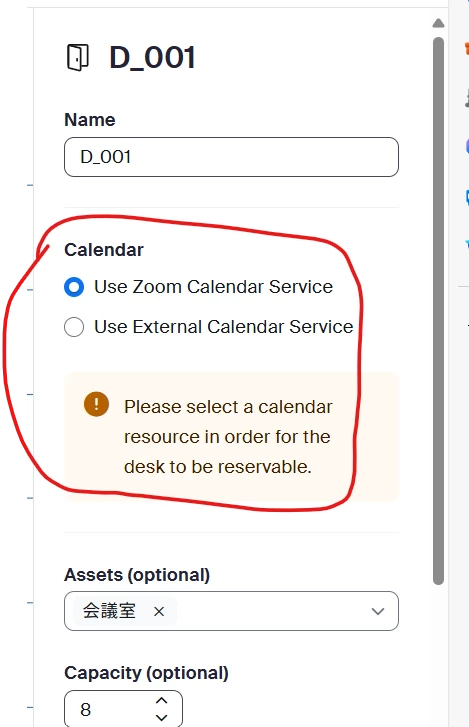

Hey, @yu_gnk
Did you forget to set up a calendar for the Room?
If the calendar is not set up, it will be grayed out and unavailable.
Examples are displayed in the figure below.
Configuer floor map and set up a calendar for the room.
