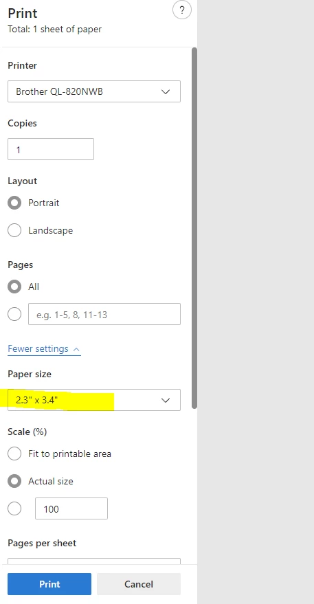

Zoom has recommended the Brother QL-820NWB.   They run a little over $200.  We have set one up for a test and eventually got it working.  You can attach it either by a USB cable, Bluetooth or Wi-Fi. (We tested it both via Wi-Fi & Bluetooth). You may need to download the drivers from Brother to make it work.  Order the DK-1234 labels to print the badges.
Also, we initially encountered printer errors.  Turns out we needed to update the printer settings to make the paper size 2.3"x3.4" to match the paper size in the printer.  Once we did this, it worked.  We also tested both portrait and landscape.  Portrait appears to work better for our needs.

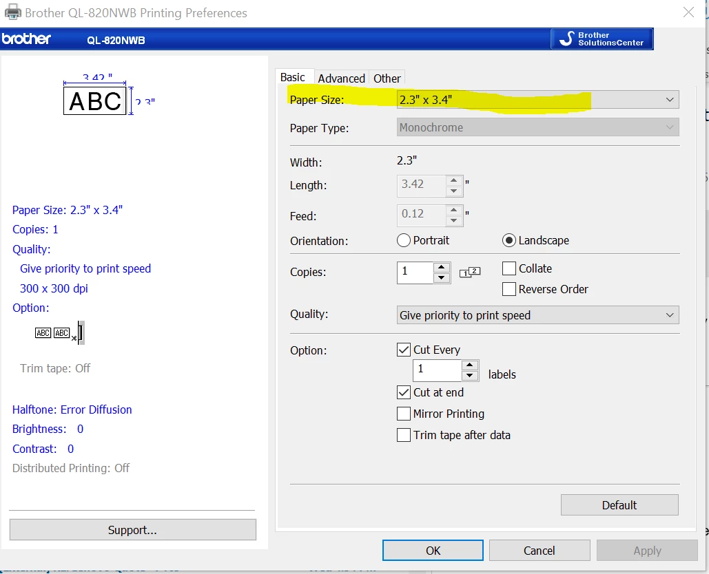

Mar 7, 2024 4:56 PM UTC
So did you get the Paper size set up for the printer in the Printer Preferences like below?
Once we did this, and the paper size on the printer, when we printed a badge everything worked!
Mar 13, 2024 2:51 AM UTC
Appreciate your help on this but getting the error "The roll of labels or tape inside the machine does not match the one seelcted in the application". Can I confirm you are using the label 62mm x 5m (2.4" x 16.4"). The label came with the printer
Mar 13, 2024 11:44 AM UTC
That was the same error we received when we got our printer and was attempting to print, using the rolls that came with the printer.  While we were working through the error and talking to Mr. Google was less than helpful we realized the labels that came with the printer were too small for what we were looking to do.  We circled back and ordered DK-1234.  When those came in we initially received the same error until we figured out the mismatch issue by reading the details on the error message.  From there it was a matter of getting the printer preferences on the device to match with the paper size.  Once we did that as shown in the previous post everything started working.  If it is anything past that, not sure what it would be.
