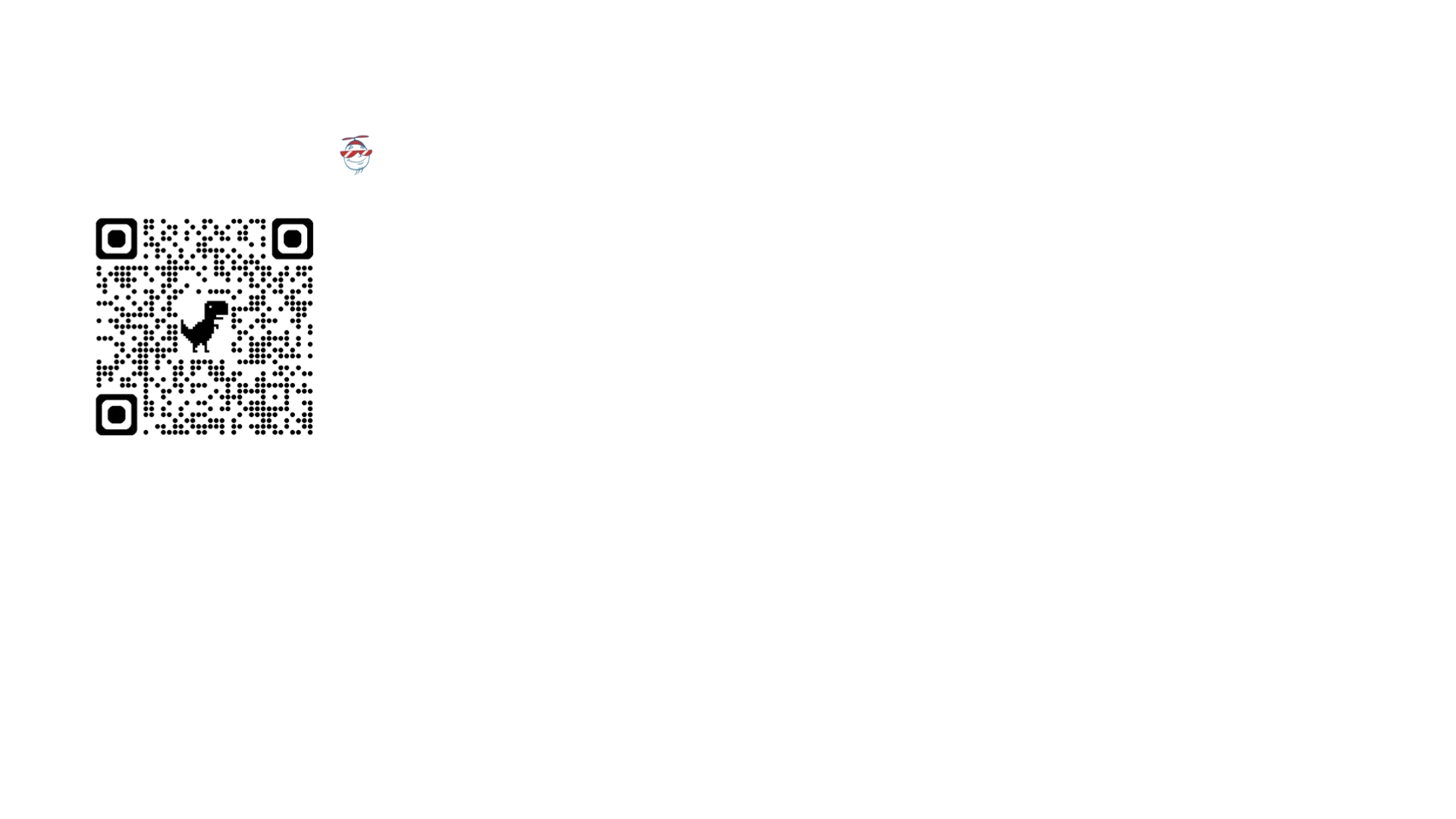

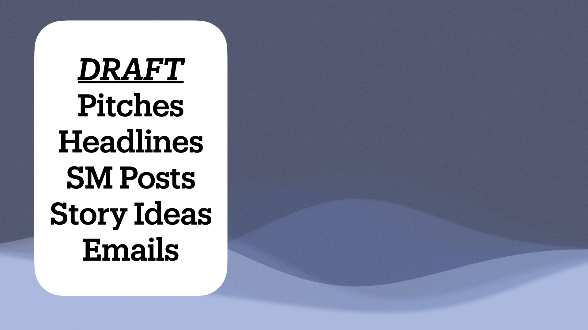

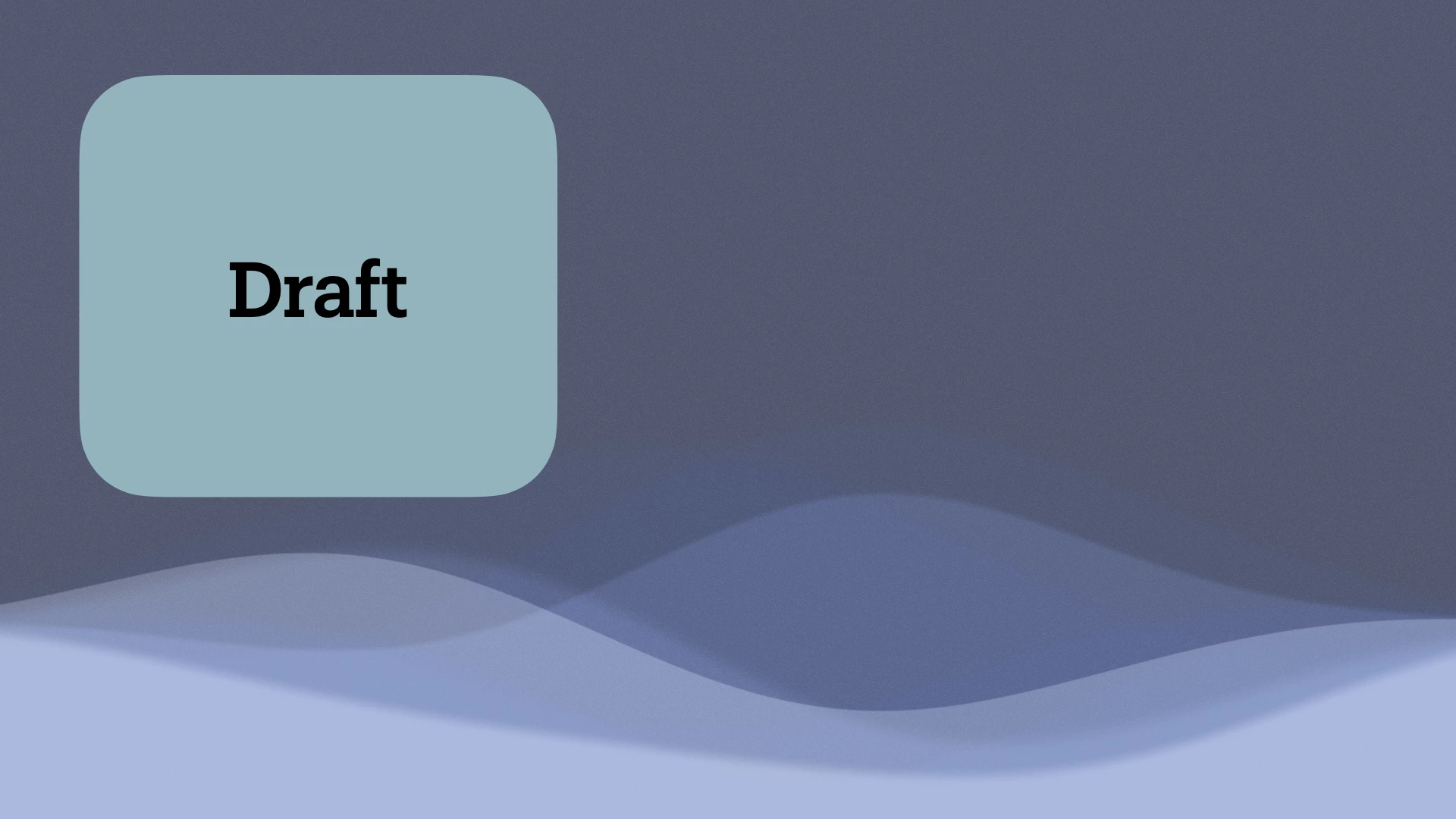

It's a little clunky, but with some experimentation, you can create backgrounds with readable content.
Because there's always the issue of the virtual background 'eating' parts of your head, you need to keep the slide colors pastel and within the same tonal range as your plain clothing. Good lighting that separates you from the background. Don't move around too much - side to side or forward/backward. Keep the contents super simple and sparse (right down to bold, sans serif type).
I create a folder of PNG's from the slide deck (Keynote on a Mac) with transparency turned on.
You can add a folder of images to the virtual backgrounds popup. Then 'switch' between them while you're live.
I used 20 slides for a workshop on Saturday. Here are three screens to give you an idea of how it works.
The slide with the QR code has an alpha channel and is set to No Fill. The visible content comes up as a jet black background in Zoom with a dramatic effect for the overlay.
