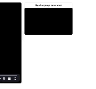

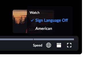

    3) If you start sign-language interpretation and are recording the sign-language interpreter, viewing the recording in the Zoom Viewer (i.e. Directly in the Zoom Recording page) will give you a little interpreter icon.  If you click on this and select the sign-language that you are interested in, the sign-language will be synced with your recording in the upper right hand corner of the browser where you are viewing the recording.
