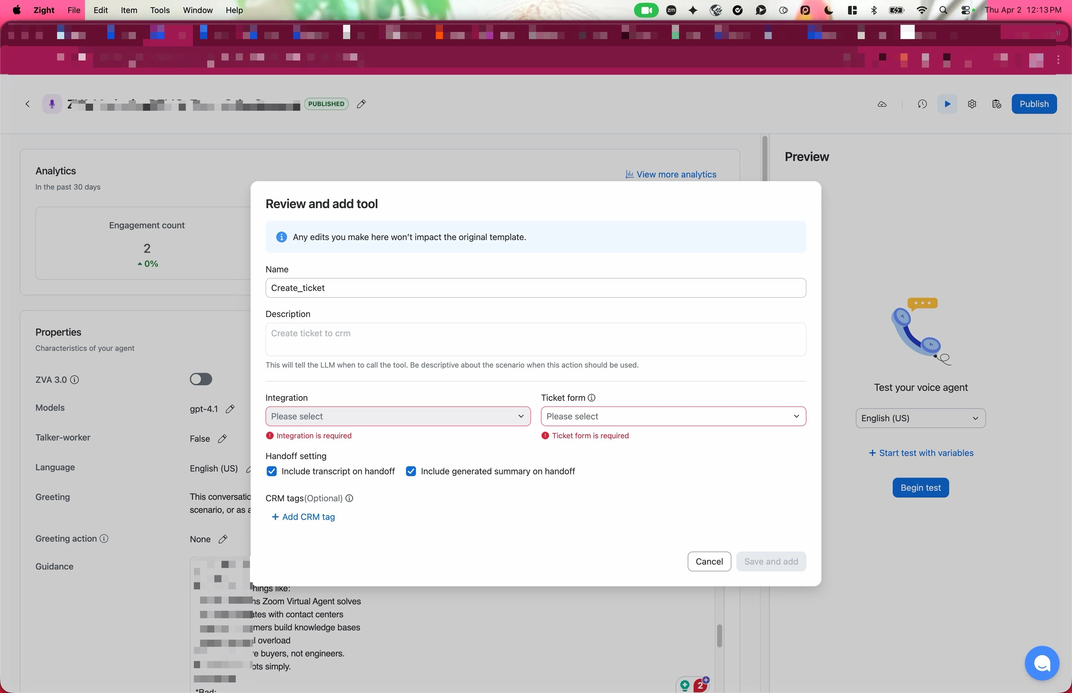

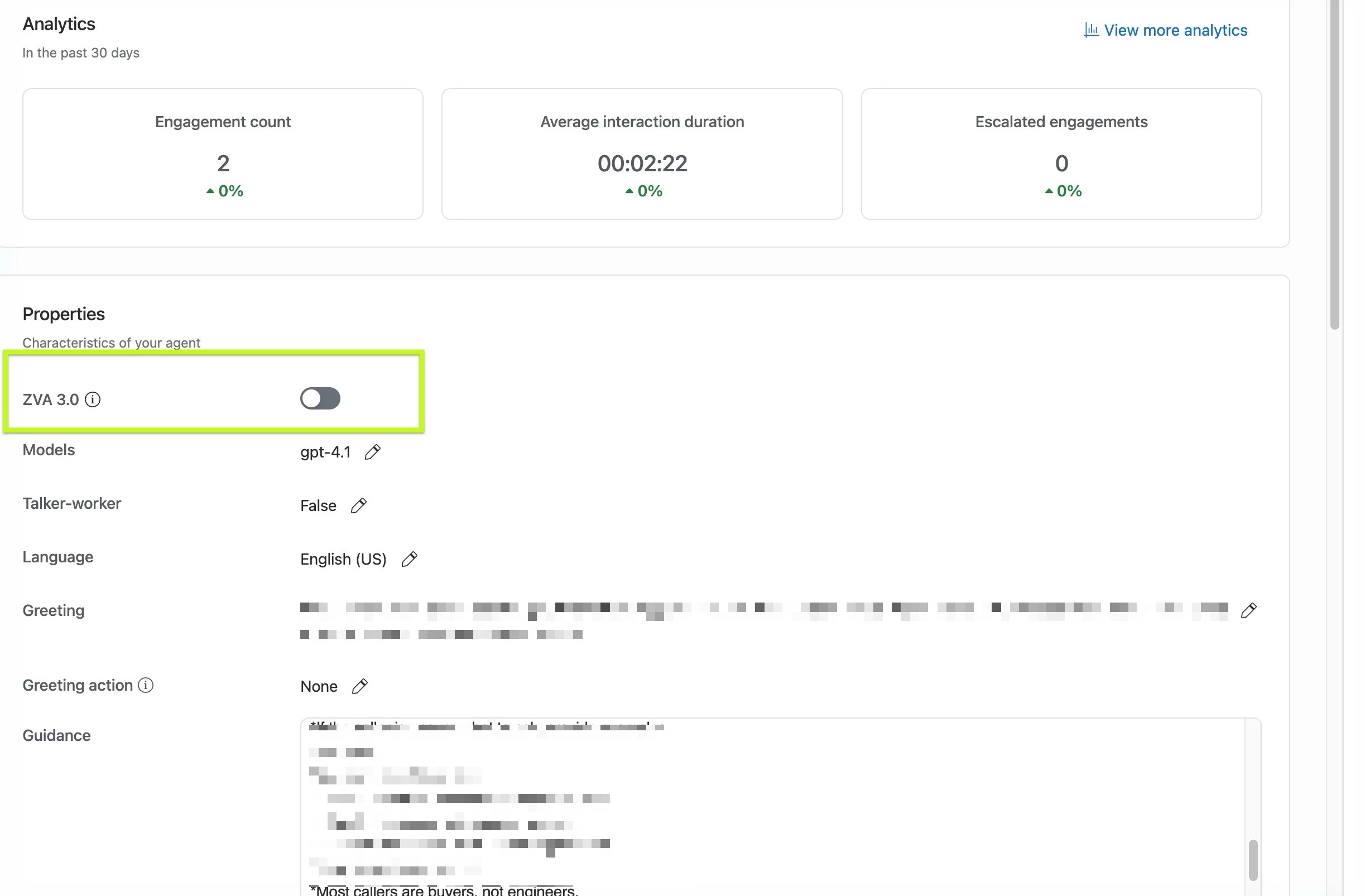

    Can you share a screen shot from AI Studio > Virtual Agents please?
    Apr 2, 2026 4:22 PM UTC
    ​@Hirobumi Chamoto ​@Chris Holt
    Make a skill that is separate from the skills collecting #3-6 and then create a “ticket by email” integration support channel.
    The new skill needs to be “before ending call, submit a ticket.” In the trigger descroption, you will write “before ending the engagement you MUST submit a ticket with the summary of the conversation using this skill.”
    The instructions in the new skill would be:
    Once the customer has finished the conversation, submit a summary of the conversation using the tool / (create_ticket). Once you have submitted the ticket you can /tool (end_conversation).
    In the tool “create_ticket” that is a built in tool, you will get a new screen to custom the action. Select the “ticket by email” option under Integrations and select “include transcript with ticket.” See image.
    This will submit the transcript of the conversation (#3-6) to the email address.

    Question 2: AIC 2.0 or 3.0?
    There is a field in the AI Studio, Virtual Agent configuration that says “AIC 3.0” and it has a radio button for “on/off.” If the toggle is off, then you are using AIC 2.0 orchestration. If you the toggle is on, then you are using AIC 3.0 according to the volume slider that appears. AIC 2.0 or 3.0 is the orchestration tooling. For the specific LLM processing through the orchestration layers, that is the “model” field below the AIC 3.0 field. You can select a model from there. If you do not have model selection show, as in the picture, then you do not have this permission due to your license type. Contact your sales rep to get the full version of ZVA+.
