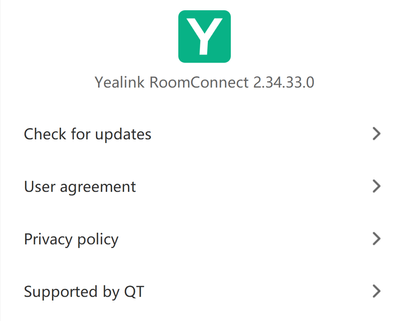

Hello, any way you could activate that download again? I'm at the same spot, the Yealink Room Connect software doesn't detect the mic and speakers on the device.
2024-12-05 03:35 PM
Hi @Jholly10 ,
Unfortunately, you'll need to contact Yealink support and ask them to reopen the link to the file : Yealink Plug-in Software(2.33.43.0).msi. There might be a newer version now that works now, but this is the one we're currently running without issue. Yealink support are pretty good at responding to the request promptly!
2024-12-05 04:04 PM
Here is the most recent Yealink plugin for zoom rooms I got from Yealink https://ticket.yealink.com/ticket-service/attachment/downLoadFile?path=Wv7HOxX28YR5EoYyLPf3KA%3D%3D
2024-12-12 07:05 AM

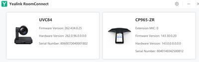

Thanks that got me further along. My CP965 can now detect its own speaker/mic in a Zoom Room. They can be selected, but there is no sound or mic input/output happening. Did this happen to you by chance?
2025-01-14 11:40 AM
Did you ever find a solution here? I have the same problem with no mic/speaker functionality. I reached out to Yealink as the issue seems to be with the version of the Yealink Plugin for Zoom Rooms, but haven't heard back. Thanks!
2025-01-14 12:10 PM
We had issues as well. Ultimately, the solution was to completely uninstall the Yealink Plugin and the Yealink Room Connect Software as an admin. Then reboot and reinstall both applications (Plugin for Zoom Rooms, see link in @lorenfl's post above) and also RoomConnect which is under "Firmware" at this link: Yealink Support
Be ready to pair the devices again, if necessary, sometimes breaking that connection and re-establishing it can fix a lot of issues.
Beyond that, no idea.....Yealink support isn't the greatest and Zoom Support doesn't debug these issues (although that is a bit short-sighted IMHO because it's marketed as Zoom Hardware, which means there is/was a collaborative effort between the two companies).
