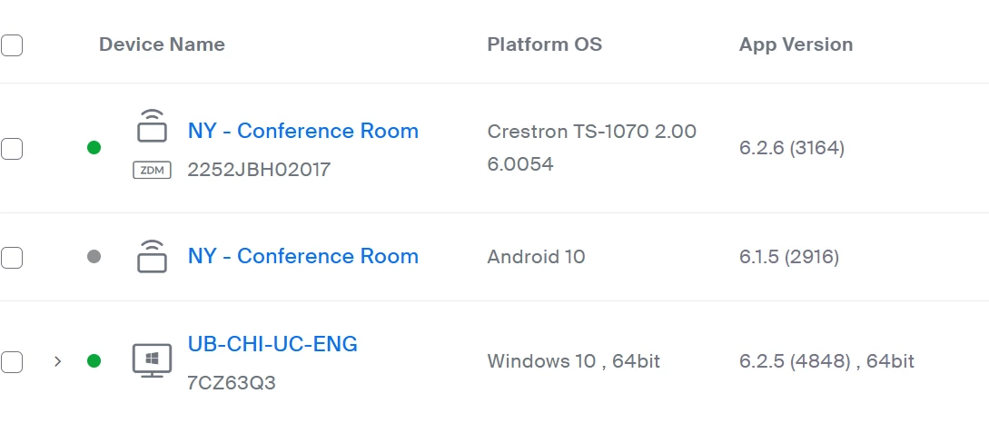

Hello,  I have a new Zoom Room and I cant figure out how to adjust the time on the Crestron Zoom Room Touch Pad.  can someone point me in the right direction.  here is my setup for this room
Best answer by bstrelko
You'll need to modify the time-zone on the Crestron TS-1070 itself.
This can be done via the device's web UI (click the device name, grab the IP address, and navigate to that address via web browser - you'll then be able to change time-zones once logged into the device).
You can also do this via Crestron Toolbox, but if you are not an AV professional/integrator/consultant (I'm not making assumptions), you probably don't have access to this and the UI will be your best bet.
