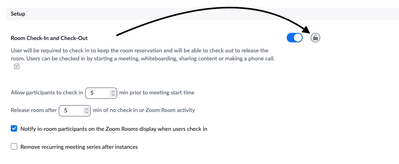

Hello @Jfr,
When you go to Room Management > Zoom Rooms > Account settings > setup > is the Room Check in and Check-Out locked by the admin here? (Screenshot)
Thanks,
Brandon
2022-08-26 01:31 AM
Hi @YaBoiB ,
thank you for your answer but it still doesn't work.
It was off (unchangeable) and unlocked, now It is off and locked. 😐 (Screenshot)

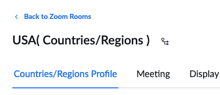

@Jfr ,
You know that you can go in to the main Zoom Room settings, or you can go into the location settings like I did below for my testing account for Zoom Rooms. Check in all locations. It has to be locked by either an admin or owner of the account for it to be greyed out by another member.
Thanks,
Brandon
