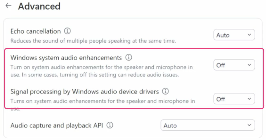

Best answer by HappyZoom
Please disable these options and try again.

Look at HappyZoom response, it fixed the issue!
HappyZoomAnswer
December 10, 2025
ZoomJaredAuthor
December 10, 2025
Holy cow that worked!! You are a life saver!
