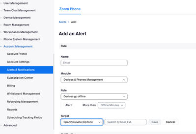

    Also, I recommend setting up an alert, so you can notified if a phone goes offline. See screenshot:

    PS I have activated the Zoom alert as recommended by sachinzoom, but the minimum offline time you can select is 5 minutes.  My staff notice the drop usually during a call and reboot immediately, so I never get the alert notification.
