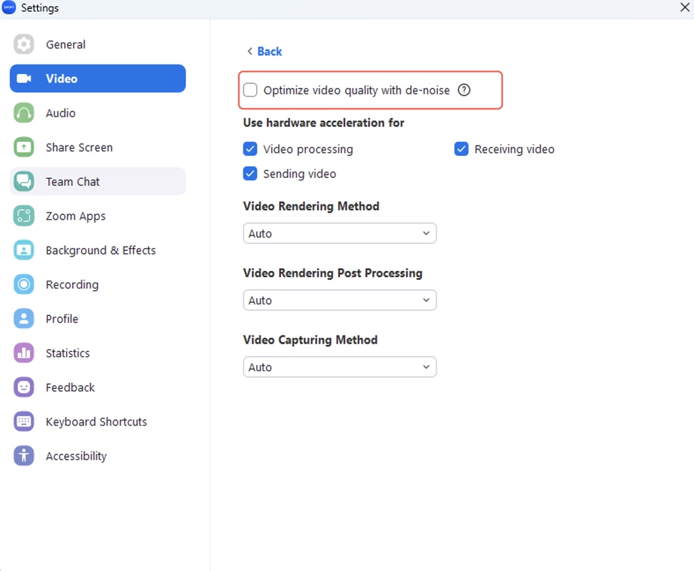

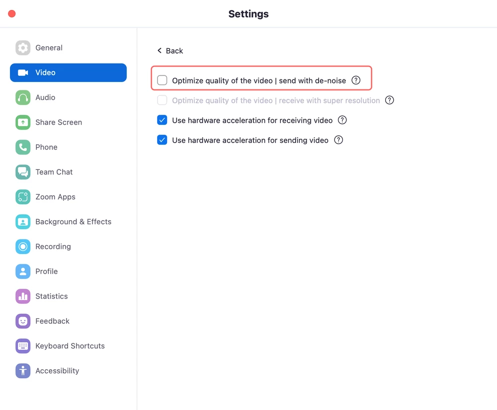

    They have reproduced the issue and found out the root cause, the video de-noise function goes wrong when the CPU usage is high on some computers with low-performance CPUs. If your Zoom desktop client version is currently in 5.13.4, you may follow the workaround below to fix the issue.
    As a workaround, disabling video de-noise in the advanced video settings on your Zoom desktop client (pic1:Windows, pic2:Mac) can avoid the issue.

    Have you tried the following? Worked for me (Windows):
    Go to your (Zoom) settings, Video, (bottom of the menu) Advanced, Uncheck the "Optimize Video quality with de-noise".

    Video settings:Adjust low light to manual
     In advanced Tab *un* check "optimise video quality with de-noise"
