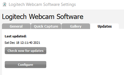

2022-01-02 09:16 PM
It doesn't give me a version number, but says its last update was 12/18/21 the day I submitted the post. I probably did that to troubleshoot as well, but forgot to mention it.
