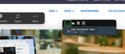

If you have just the one screen, like a laptop or standard desktop, you should see a smaller version of your other participants' videos (as shown in the screenshot below)
Note: you can change the layout of these smaller video tiles, so they may be hidden like so:
In my quick test, I did notice that the video thumbnails are not shown at all, if everyone has their video off. So, if all your students have their video off, that could explain their missing videos during your presentation.
