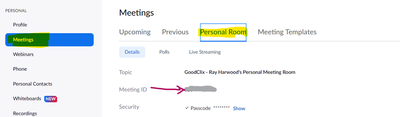

So there are two "normal" ways to meet. One is to use the Personal Meeting ID (PMI) that is assigned to your account. (If you have a Pro account, you can change it to another PMI.) The other is to Schedule a meeting and have a new Meeting ID generated. It's also possible to Schedule a meeting with your PMI, but I normally don't recommend it, because anyone with your PMI could possibly join a session that they were not invited to.
Your PMI is located here on the zoom.us web page (mine is redacted for confidentiality) in the Meetings menu under the Personal Room tab.:
So I think the issue here is that you are going to your PMI room and they are being sent a URL that points to a generated Meeting ID. If you are scheduling a new meeting, you should always join by clicking on that meeting... not on your PMI meeting.

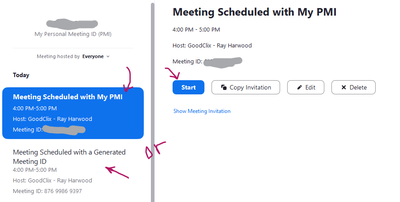

Here is the place, when creating a new meeting, to tell it whether or not to generate a new Meeting ID or use your PMI:
See which radio button is clicked when you Schedule a new meeting. If using the Zoom client application to start your meeting, you should always join the meeting by first selecting the meeting you want to start, and then click the Start button.
