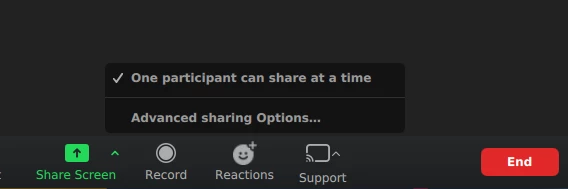

As you can see, the relevant option is just not there (although I am the host):

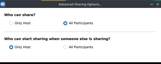

Clicking on "Advanced sharing Options..." reveals the following:
I tried to change those options but it does not solve the issue.

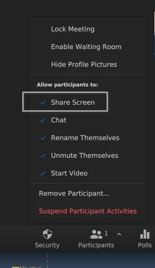

I did activate the screen sharing in "Security" before trying that:

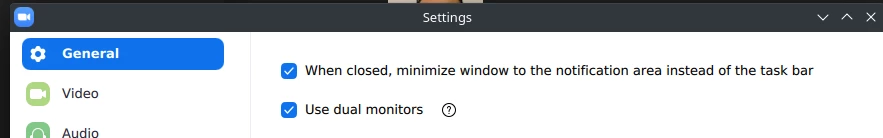

Also I did activate the dual monitor option:

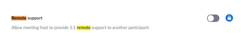

Finally, I also think that I have the right settings on the web interface that Zoom offers to change more options:

    Best answer by Raj-TiLL
    Had the same problem was struglling for many months. Here is the solution . Disable Remote Support (Lock it if you must) to get it working:
    Raj-TiLLAnswer
    May 12, 2022
    courtiolAuthor
    May 12, 2022
    Thanks so much Raj-TiLL! This issue had really negatively impacted my teaching and I can confirm that this is indeed THE SOLUTION. I am very disappointed by Zoom's official support for 1) not making this clear in the settings and 2) for not answering earlier to this post.
