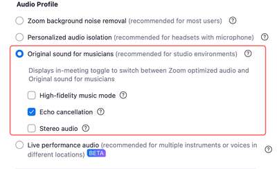

I assume you are using the "original sound for musicians" setting for music lessons, can you please make sure you both (especially your students) have the "Echo cancellation" checked?
Hope this helps.
