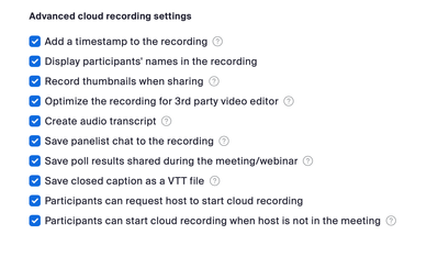

Dear @lprimerano ,
Could you please check in your cloud recording options whether you have the option "Record thumbnails when sharing" enabled and disable it.
From the documentation that should remove your video thumbnail.
In the FAQ your case seems to be the first question, just in reverse:
https://support.zoom.com/hc/en/article?id=zm_kb&sysparm_article=KB0061246#h_acaffbd8-27a3-4683-b3a0-...
