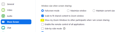

Hi @Wacko_Jacko
You should be able to set or unset the visibility of your Zoom interface to other participants in your Zoom Settings, under Share Screen:
Does this work for you?
If participants are seeing what you are doing in other applications in the background on your second monitor, then you should look at sharing an application window only - rather than full screen.
Hope this helps. Please post back with results.

Hi @Wacko_Jacko

Hi there,
I have the same problem with floating meeting controls. All participants can see my controls and what I'm doing in the background. I tried to find the setting to set or unset the visibility of your Zoom interface to other participants. But unfortunately I don't have this setting that you highlight with yellow circle. What do I need to do now?
Looking forward to your answer)
