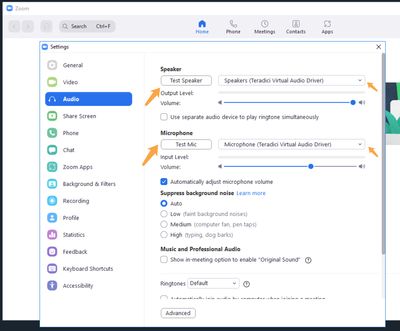

Hi @WillThalheimer thanks for the additional information. Ok, I think we should go into the Zoom client before you try to join a meeting and start there, see what the audio settings are showing.  If you can open Zoom (I would still recommend closing any other apps running which may use the mic first) and click on "Home" at the top and then the little settings icon in the upper right
Click on "Audio" on the left and then you will see audio settings. Here you can use the drop downs to pick your speaker and microphone, and even have "Test" buttons that let you test Zoom outside of a meeting. There are other audio settings there, too, such as suppressing background noise (sometimes Auto works great but you can also set this to High if needed). What happens when you play with the different speaker and mic options and test each one?
Depending on how that goes, you may find the answer by tweaking these options.
Further, at the bottom of the settings window is an "Advanced" link, if you click that there are some more audio settings related to the Windows Audio Drivers.
I do hope tweaking some of those gets you up and working!
