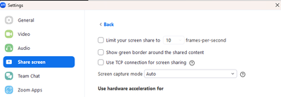

storyhub
go to settings > share screen > advanced > and uncheck "show green border.."
