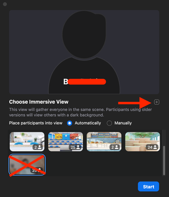

When using Immersive view and a "custom background", has anyone had trouble removing their own image as a host? My use-case is to set up the zoom meeting and be the controller for Immersive View for a panel discussion. The problem is when I add my own custom image for Immersive, I have no way to get rid of my Video. My name doesn't even show up in the list of names when you manually add people in the meeting who you want to be on-screen. My video just automatically pops into the immersive view when I launch. I cannot even "x-out" my video once Immersive view is started with the custom image. When I use the zoom default images, I can keep my image from showing up or x it out once immersive is started. Is this a glitch in Immersive View?

When using your own virtual background as the Immersive scene, it is using your virtual background exactly as it appears when outside of Immersive view, thus you have no control of your size/shape. I would recommend uploading a custom scene, instead of using your video as the immersive scene, which will allow for all participant videos to be adjusted:
Just tested this on my end and had no issues resizing my video.

I was not using my background as the immersive view scene. I had done what you illustrated above and added a custom image following the specs on zoom. Then when I "Place participants into view" Manually, I see their names in a small box where I can x-them out if I don't want them in the view on-screen. The problem is that my name, as host, does not show up in this list to x-out. I tried starting the immersive view anyway and my video square was not able to be x'd out or dragged out of the immersive view. This only happens when I use a custom immersive scene. When I use the defaults, I am able to remove my video from the Immersive view.

I see what you mean. I would assume this is just a limitation of Immersive Views, since only the host can start this view, but can understand your use case and that it's odd that the limitation is only for the custom option. I'd suggest submitting some feedback about that so that our teams can evaluate that and consider changing that logic to allow the host to be hidden.

It is an issue with zoom. What I do is, make my video as tiny as possible and hide it behind one of the other people in the immersive view. Then I dissappear. Lol It works.
