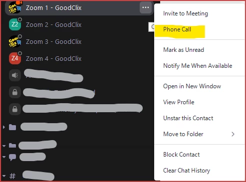

So I did a quick test, without the results I'd hoped for.  I have one of my assistant users (Zoom1) in a meeting with me, and when I click on them in my Contacts or Team Chat window, this is the menu I get:
Obviously I don't want to invite them into a meeting... they're already there. All of the ones below Phone Call are not helpful.
The only option then is Phone Call.  Note that this assumes you have Zoom Phone; if you don't, you can certainly have a regular (outside of Zoom) phone call.

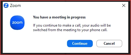

The issue here with Zoom Phone is that -- while Zoom will allow you to remain attached to the meeting (the Zoom video screen will still be visible) -- your audio will disconnect from the meeting while you make the call.  (The Zoom app can only connect one audio pair [mic and speaker/headphone] to one Zoom app.)  So -- if you don't need to maintain audible contact with your working students while you converse with your observer -- this could work. (They can raise their hand or use Meeting Chat to signal if they need something.)
When you exit the call, you simply reconnect your audio to the meeting using the Join Audio button, located where your Mute/Unmute button usually sits:
None of this is "super easy" or ideal.  You've got a pretty atypical use case here, and it's unlikely (but not impossible!) that Zoom will develop some approach that would work for you.  I've thought of a few different/additional approaches... all of which are similarly complex or involve additional hardware/software expense.
