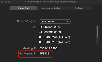

If their audio and video are separate in Zoom, that means they did not provide their participant ID when they dialed-in. Their participant ID can be found in the meeting dial-in info within the meeting (not in the invite).
When this info is provided when dialing-in, Zoom will automatically combine their video and audio into one participant, so that both move into a breakout room together.
