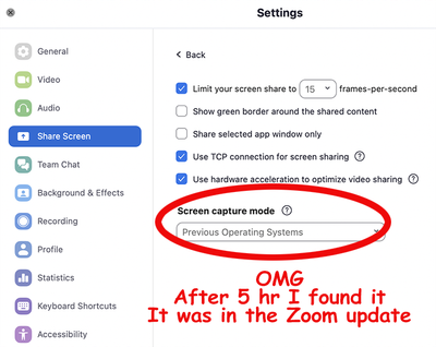

I had a problem. I was a good boy and updated zoom. It seemed OK until I shared screen. I could share screen but when I interact (move my mouse) within any interface there is a lag that shows a small black box sometimes as my mouse reached an interactive interface area or the whole shared screen goes black for the students when I click anything. A few seconds later the black clears and looks good.  I tried typing in a text box for help, the screen went all black. When I click outside the text box my shared screen comes back.
This was happening in Photoshop, my browser and any application I tried to interact with, both sharing desktop or application every zoom setting I could find that may effect sharing. The worst part is it worked just fine last week pam and I checked.
Do you think “Screen capture” would affect screen sharing? I did not. But it does. It seems like one of those bad jokes from IT.
I hope you don’t get trapped like I did. Here is my "screen capture" that I’m sharing.
This fixed it!  It's still good 1-3-24, no problems.
