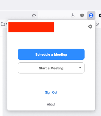

Thank you for the solve! I was actually able to get to the options page from my zoom browser extension, by clicking on the Gear icon in the top right:
From there, I followed your instructions and fixed the problem. Thanks again!
