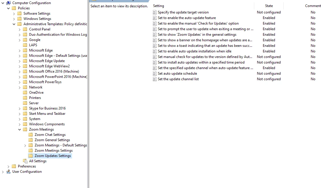

Separely, we also have GPO's applied to this computer (not user), which are shown below
What am I doing wrong? The documentation is unclear when talking about deprecated policies and the introduction of the newer AU2 policies.

I do have some GPO's being applied at the machine level. I have now just disabled those from apply to my test machine, so will wait for that to filter down and check back later.
Ok, turn out my GPO's were interferring. I had "Set to enable auto update = disabled". Although I believe this was the legacy setting, so wasn't sure it would have affect if AU2 policies were also in use, but it seems it does. With this setting set to 'enabled' or 'not configured' my Zoom started prompting for updates now. Thanks for all the help and suggestions.
