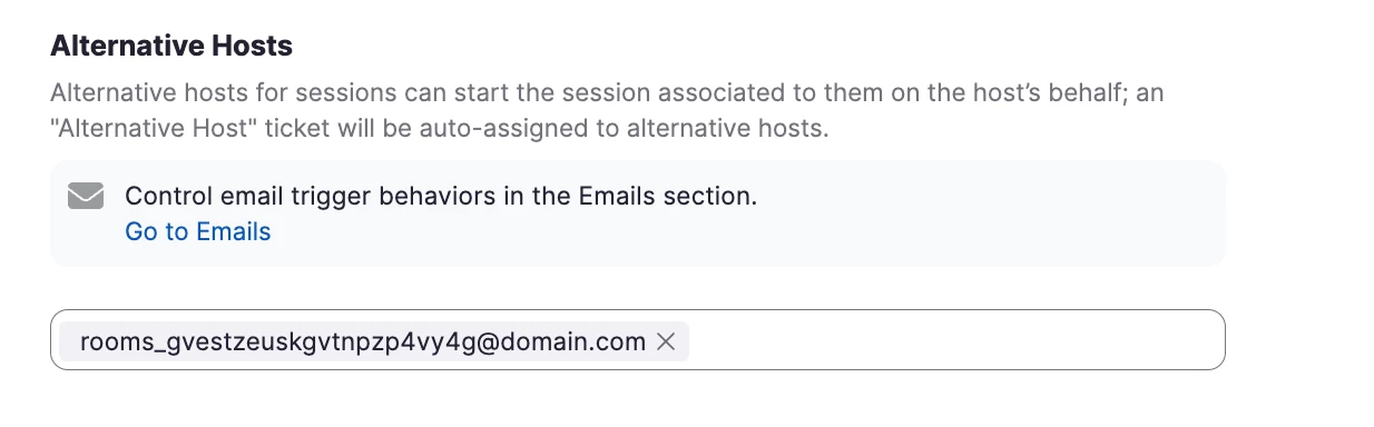

Is there a simple way to add ZR as an alternative host for Zoom Events? We attempted to add ZR by using email address, but it didn't work. Currently, we are using the ZR pairing method, which is more difficult and time-consuming, especially since we need to add 5-10 ZR to Zoom events.

    I found a way for it, this is what I did,
    1. Under sessions, add the ZR as speaker using the ZR email address
    2. Uncheck Display Speaker option and keep alternative option checked
    3. On the controller you will see the event details appearing for the respective event with the start/join option.
      Note: You won't see the invite on the actual room calendar but it appears on the controller.
