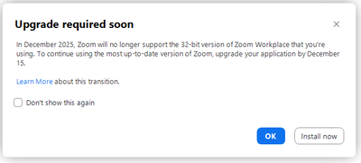

  3. FIRSTLY, install the 32-bit version first (DO NOT install 64-bit until later) - 32-bit Workplace will install and then launch and you will get a warning that this version will become obsolete in December 2025.
  4. STOP - There will be a link on the screen implying that clicking that link will download Workplace 64-bit.  DO NOT CLICK this link because it will download Workplace download 32-bit AGAIN and you will be stuck in an infinite loop of installing Workplace 32-bit.

@virt-danceroom Only on 64-bit systems will the Install Now button appear
The flow will like this:
1.launch Zoom will enter this prompt
2.click Insall now, will redict to this link
https://zoom.us/support/down4j?admin=false&archType=x64
3.The link will prompt to download 64bit Zoom automatically
We will adjust the link to download the correct installation package according to your system.
I'm wondering what specific link you encountered in your case? Could you copy the link here?

    • Then when I clicked the download link on this warning page that implicitly hinted the result would be a 64-bit download,  I saved this install file in a different directory - just in case
    • Following the download of this new install file put me back at the same warning screen, telling me that 32-bit was being phased out -
      • I was back at the same screen with a worklplace that  launched, but with the same warning message - meaning that I had installed 32-bit again
    • This told me that this link was downloading the 32-bit version, so after ending up there a couple of times, I went to the original directory where I had downloaded the  64-bit version and installed it - and VOILA! 64-bit workplace launched successfully - after how many hours this issue had perplexed me?
