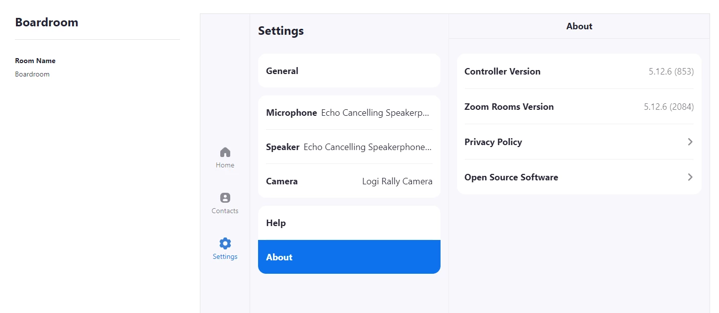

    November 23, 2022
    that still looks like the previous version.  Can you check on the Zoom Admin portal what version it is showing?
    CounoTechAuthor
    November 23, 2022

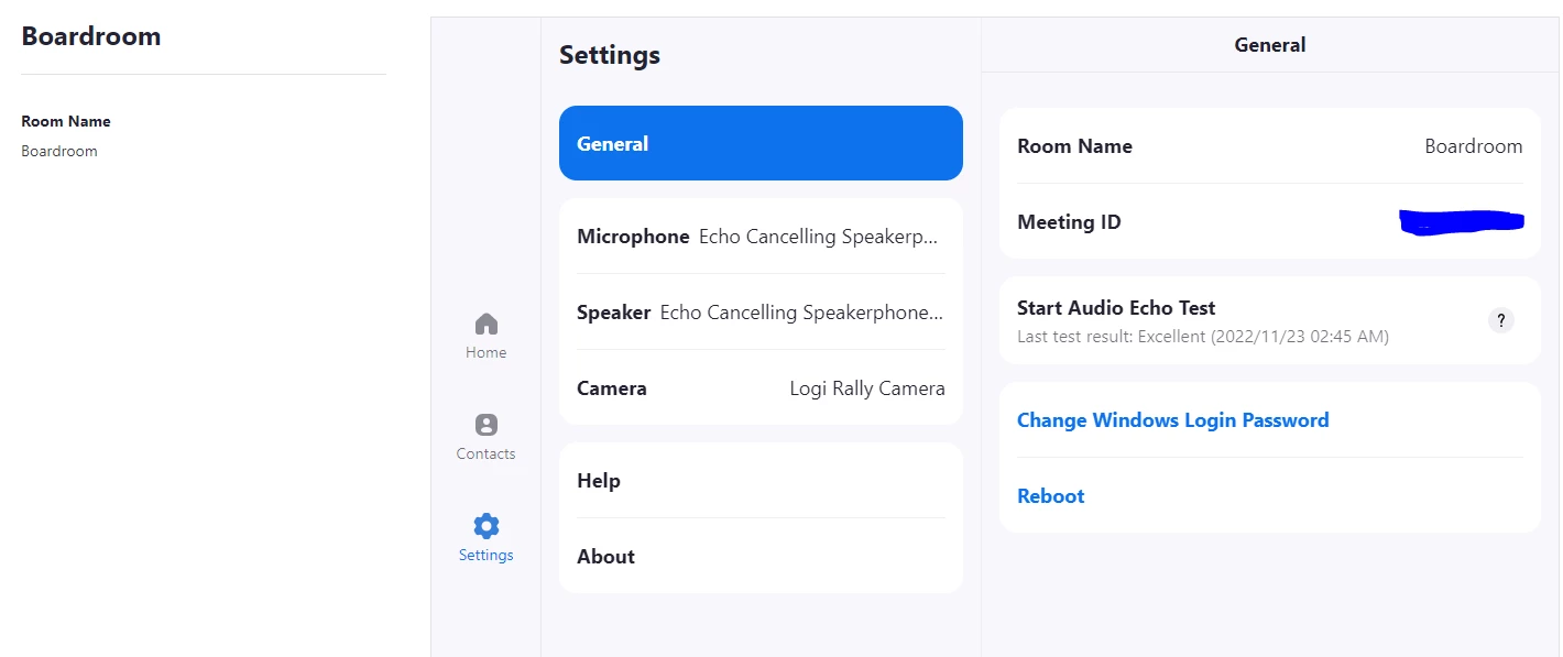

    That definitely should then be able to do dark mode.  Could you check on the controller under "Settings" and then "General" if the "Theme" is now showing and what it is set to?
    Hey.
    No "Theme" shown 😞
    CounoTechAuthor
    November 24, 2022
    From the client
    This is the boardroom tablet, and I have also checked all the other devices and they all look the same.

    @CounoTech I need to get some clarity here as this might be the issue.  The screenshots you previously shown me on this thread stated iPad as the controllers.  But the new photos you shown me of the controllers are actually Logitech and those look to be USB based to a Windows Room.  Is that correct?
    If so, the iPad controllers should now already show dark mode as that is supported today.  The Logitech via USB mode to Windows based Zoom Rooms is not supported right now.  This should change really soon but I can't give any dates on this.
    CounoTechAuthor
    November 29, 2022
    Apologies for any confusion.  The controller is the Logitech and the iPad shows the free busy times.  the controller goes into a Hub.  We have a similar setup with a Logitech and dark mode works without issue 🙂
