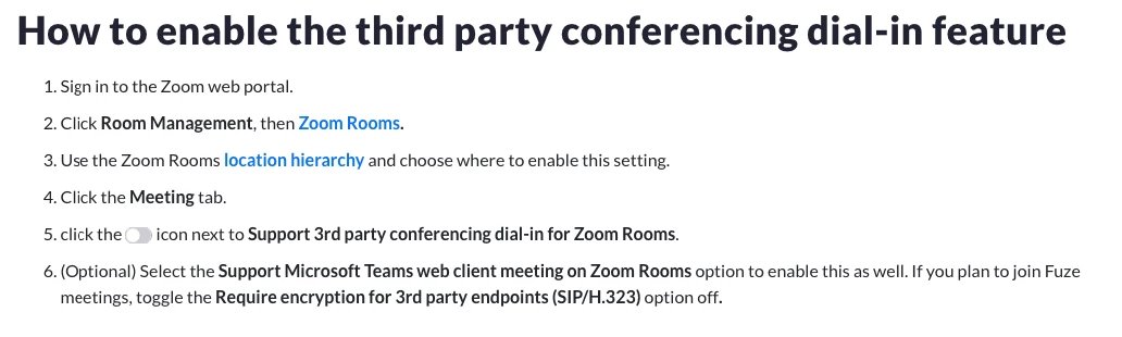

    Hi John,
        Have you enabled the third party conferencing dial-in feature in your Zoom Room? This should give your Zoom Room the ability to join Teams meetings.
    Full instructions are here: https://support.zoom.us/hc/en-us/articles/360001163206-Joining-a-third-party-meeting-from-a-Zoom-Room
    I hope that helps! Please mark the reply Accept As Solution if it does.

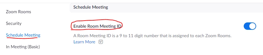

    Hi, JohnA
    It seems bug of Zoom Rooms.
    All you can do is wait for a bug fix or activate your Room Meeting ID.
