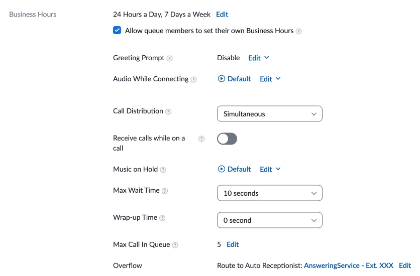

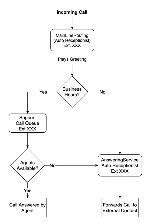

Trying to get this call flow to work (see image attached) but if no agent is in the call queue (eg; out to lunch)
It gives the following voice greeting "the person you are trying to reach is unavailable, good bye" Then hangs up instead of going to the Auto Receptionist (AnsweringService)
Have tried setting the overflow of the Call Queue (see attached) to go to the Auto Receptionist (AnsweringService) but no change.
Is this a limitation of Call Queues or should I be using a different call flow to accomplish this flow?

    October 5, 2022
    Hi @ChrisO ,
    Thanks for looking into this, see attached the AR for Overflow.  If I try and call the 'AnsweringService' AR it comes up with the same voice prompt "the person you are trying to reach is unavailable, good bye".
    We only have one local number in Zoom assigned to the 'MainLineRouting' AR.
    Let me know if you need more information.

    October 5, 2022
    I will have to do some testing and will get back with you tomorrow, but my guess is it may be related to routing externally without a calling plan in place on the AR.
    That being said, in your current configuration  the AR is pointless. The queue could do the routing you have it doing.

    October 10, 2022
    Hi @ChrisO
    Thank you for your time in testing these options, so we just need to have a licence for that AR to be able to call out or Licence a fake user and then use that to send the call externally.
    So if we buy an "Additional Phone Number" and assign it to the "AnsweringService" AR it would let you dial it out?
    The reason we are wanting to use a dedicated AR for the AnsweringService is that is allows us to expand the call flow and have one place to update the external contact in case we need to make changes.
