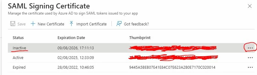

    PHjames
    August 2, 2022
    I just did this and documented the process. Hopefully it will help others. I am using Azure for SSO.
    Go to https://portal.azure.com
    Select Azure Active Directory
    Enterprise Applications on the left
    Search for Zoom, select it.
    Select Single-Sign-on on the left
    Scroll down to SAML Signing Certificate then Edit
    Create a new certificate
    Next to the new inactive certificate click the ellipsis and download the PEM certificate
    Open the file in Notepad or another text editor and copy the text between the begin and end lines
    Go to https://zoom.us/account/sso and click Edit on the right
    Paste the certificate into the Identify Provider Certificate box
    Go back to the Azure Portal, click the ellipsis next to the new certificate and make it active.
    Go to your Zoom app on your computer and sign out. Sign back in to make sure it’s working.
    Job done
    Zoom gives you plenty of warning about the expiry of the certificate so it’s best to do this in plenty of time. If you have problems then download the existing PEM of the old certificate and copy and paste that into the Zoom portal to put things back as they were. Then disable the new certificate and re-enable the old certificate.

    March 8, 2023
    Just logged in to say thanks to @PHjames for providing the guide above. Just one thing to mention, when creating the new certificate in Azure, there is a drop-down choice for 'Signing Option'. Here, I chose 'Sign SAML response and assertion', which I assume is the correct option. It's working in my environment.

    This is great except for this part:
    "Next to the new inactive certificate click the ellipsis and download the PEM certificate"
    I don't have the "new inactive certificate" - that's the step I am missing - how do I get that?
    PHjames
    August 9, 2023
    When you click New Certificate, you need to click Save. Then click the 3 dots to the right of the Thumbprint and select 'PEM certificate download' like in my screenshot.
