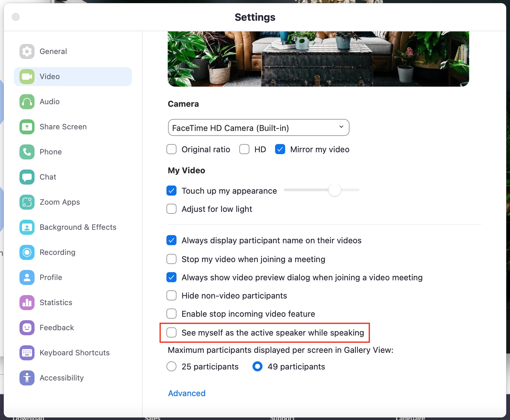

    Hello @Qwertyportne ,
    Thanks for your question! The other attendees are seeing you as active speaker in the meetings if your camera is on. You likely are not seeing yourself as active speaker due a personal Zoom account setting. If you DO want to see yourself in future meetings, check off the box in your Video settings that says "See myself as the active speaker while speaking". Please see the screenshot attached. This will only affect your personal experience going forward.
    Best,
    Kelly
