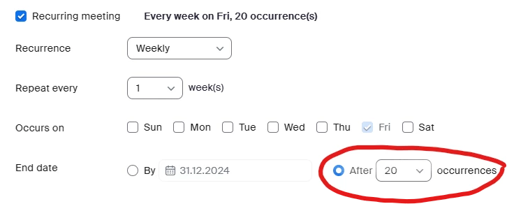

    Hi All,
    I was having the same problem as everyone else, mostly occurring on the Zoom app on iPads.
    Zoom have changed the length of recurring meetings end date/occurrences that you can set when setting up your meeting.
    Try this fix.
    You can only set for 20 sessions in advance. See screenshot below.
    Anything more than this and it won't show in the Zoom app on iPads.
    (Longer ranges of occurrences seem to still work ok on Android and Apple phones).
    This worked for me, hopefully it works for you too.
    ** Maybe someone from Zoom whom reads this might change this back so we can all schedule occurrences to be set for longer periods of time e.g., 1 year plus or infinite! **
    Cheers
