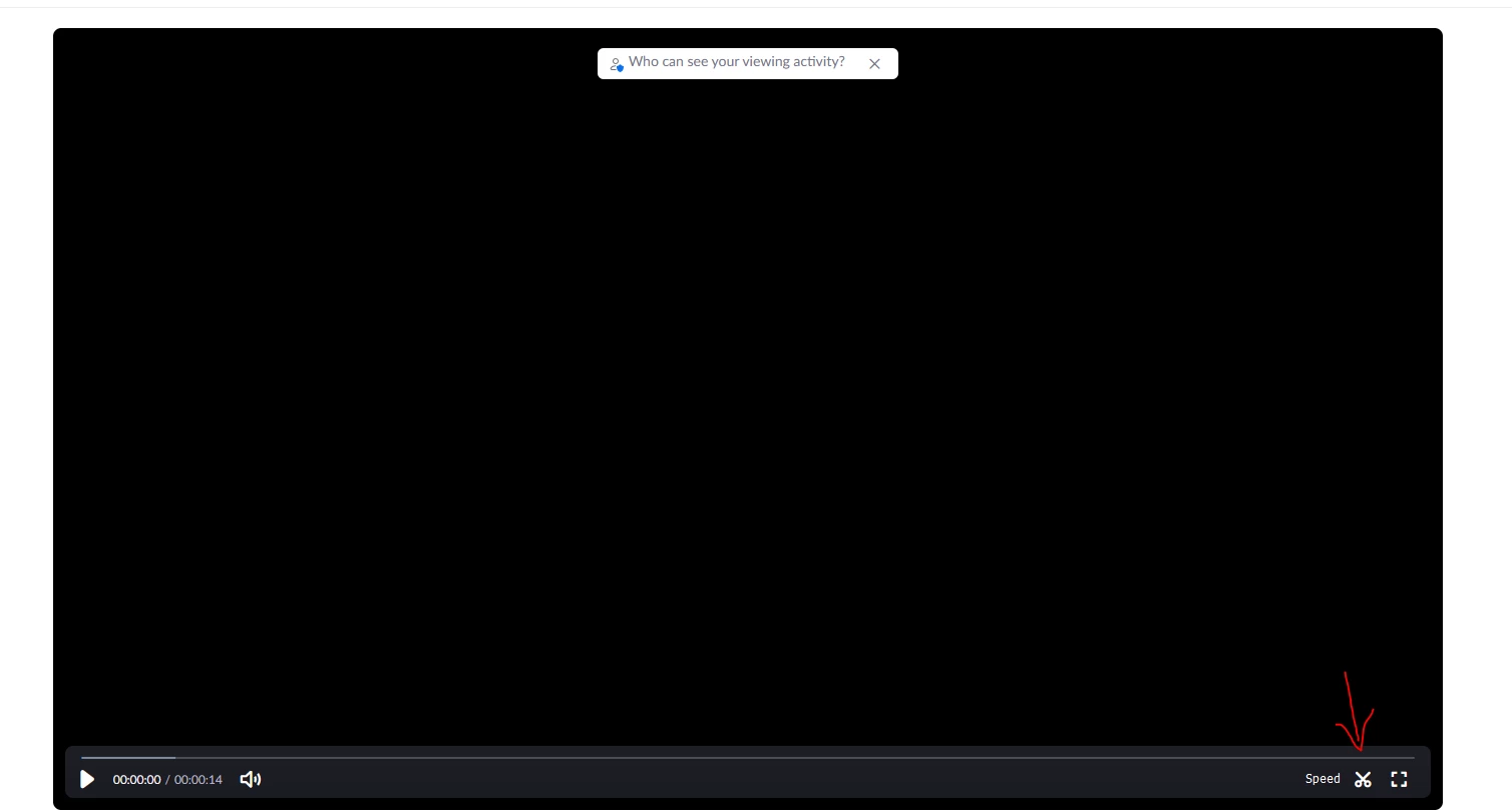

    Hi rfrazier60,
    For the Zoom recording saved online, you have to open the video to preview it. At that point, you will find a pair of scissors located in the lower right-hand corner of the video which opens the Trim function. https://support.zoom.us/hc/en-us/articles/115003001383-Trimming-cloud-recordings

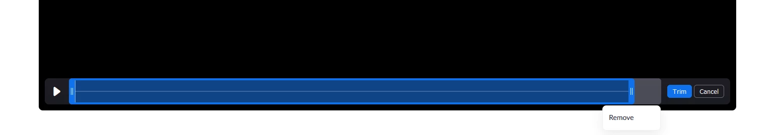

    Hi @SH28,
     The image below is how the trim feature should appear. By clicking the two vertical lines at either end you can trim from the beginning or the end of the video. If you do not see the blue bar or the two vertical lines I would suggest you try another web browser as it may be something related to your current browser.

    ChrisO,
    I am confused.  I see the blue bars but how do I know which I am trimming, the before the blue bars or after the blue bars?  The instructions or not good.  Additionally, I do not understand on what does one click to begin the trim?  What does the Remove mean?  What is to be Removed?
