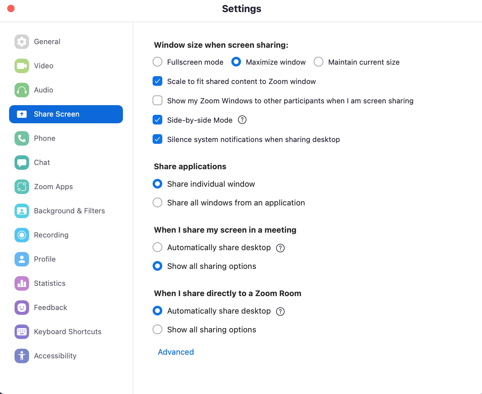

    Regarding your concern, you may check the Zoom setting, under the General options, if you have Dual Screen enabled and then go to Share Screen options, you could check out the settings related to "Window size when screen sharing".
    I will still have to check if there's an option to disable Zoom Screen Share from taking over your display

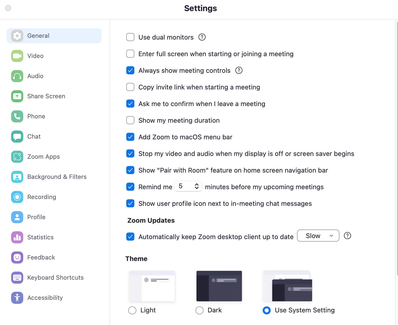

    We enabled the "Use dual monitors" setting under General.  This seems to have corrected the odd Zoom behavior.
    One additional new benefit of this setting is that we can drag the new Zoom window provided with this setting (which shows the active participant) to our second monitor (aka stage TVs) when wishing to show a Zoom participant to the in-person audience.
