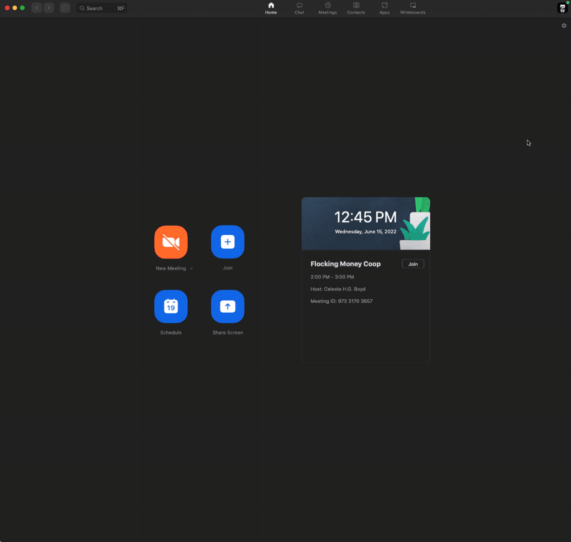

    Jun 15, 2022 7:49 PM UTC
    I did. Sadly, each time I try to select "Sign in with Google," it just shunts me back to the Zoom app, where I am still logged into my original account. See screen grab below.
